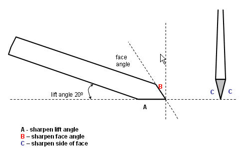

Thanks all for your responses. Brad I picked up a got a copy of “The Art of Engraving” many thanks for the tip. Mark I think the GAL article you are referring to is issue #72, Winter 2002 by John Greven.
I think I got it figured out as I just sharpened an Ongelette and Flat graver using a Crocker style graver holder on a Japanese Water Stone.   Craig I followed your advice and didn’t bother attempting to temper/re-temper.
The diagram below illustrates what I did, is this what you folks do?
Anthony Z38632.753287037
PostPosted: Fri Oct 07, 2005 12:58 pm
Posts: 575
Yes, I just found the article and that's it, Anthony! Thanks. It's a really good article, too. It also goes through how to make several of the most used cuts.
